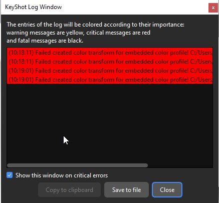

First of all, I can confirm, that when I tried dragging and dropping a CMYK PSD onto a surface in KeyShot, it didn’t load and I got the following error:
bip

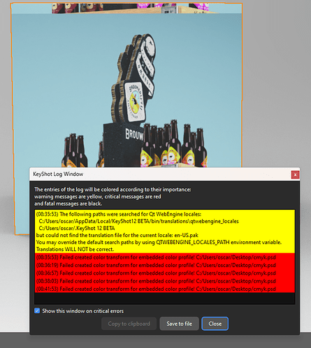

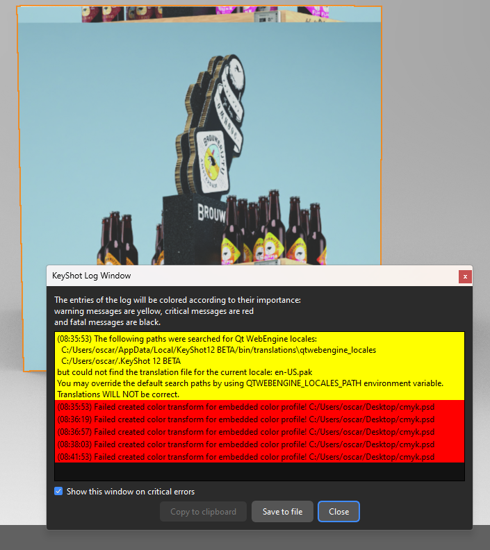

@oliver.yu Yeah it’s odd if features just get removed. But I just did a quick test in the latest beta build and while CMYK PSD gave some errors both .tif and .psd CMYK files render fine in preview. Both as label and as normal texture.
The error with .PSD cmyk file:
I wouldn’t advice using the latest 2023.2 beta in a production environment since it’s a real early beta but if you want to use it to render some earlier scenes with CMYK files, it doesn’t overwrite the existing KS installation.
